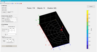

  • Hi Jitendra,
    In this screenshot, the radar is located at a distance of 2 meters from the wall, and does not display it
    Thank you.

  • Hi May,
    Regarding this query, please note that Obstacle Detection AOP lab is specifically designed to function with AWR1843 AoP EVM and not with AWR 1843BOOST EVM. The Antenna orientation and configuration is different for both the EVMs as the former has the antenna's integrated onto the chip while the latter has it embedded on the EVM board. So we believe that should be the reason as to why the customer is not observing accurate results (wall detection at 2m).
    Please refer the Medium range radar lab the customer (present in the Automotive Toolbox) which is designed to function with the AWR1843BOOST EVM which should work well at customer end and give accurate results. From there on modifications can be made to the project for their desired configuration settings.
