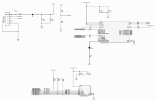

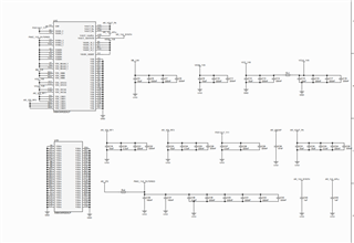

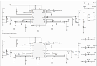

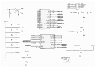

    1. No problem, the schematic is shown below:
    IO:
    PMIC:
    PWR:
    FLASH:
    I only need the board to communicate with other units through UART and try to reserve the ability to connect to MMWAVEICBOOST for debug. So I only keep the functional part of the IWR6843AOPEVM and rout some signals needed for the debug to a connector. The switches at the breakaway section for SOP0, SOP1 are also keep. All other design should be identical to the IWR6843AOPEVM.
    I use 2 LTC3633 to replace the LP87524JRNFRQ1. Their are set switching at 4MHz, forced PWM mode. The output voltages are within the voltage range specified by the datasheet of the IWR6843AOP.
    There some mistakes in these schematics: (1) I accidentally invert the two data lines of the USB connector in the FLASH schematic, I invert the data lines of a USB cable to correct that. (2) The SOP1 switch in the IO schematic should be connected to a 3.3V according to the IWR6843AOPEVM design. But since the switch remains off in all functional, flash and MMWAVEICBOOST mode, so this should be fine.
    2. As far as I know, there is no change made to the board before it starts to go wrong.
    3. I am flashing the device just like flashing the IWR6843AOPEVM. I disconnect the USB cable, switch the SOP2 switch to on. Connect the USB cable, check the COM port in device manager and open up UniFlash to flash the board. After setting up the path to the bin file and the COM port in the UniFlash, I click the start button. Then, the UniFlash stuck at the opening COM port

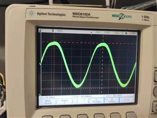

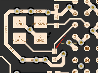

    this is the crystal part of my board:
    I probe the AR_XTAL_P signal through the pin of the capacitor:
    I just noticed that the crystal was installed rotated 180 degrees compared to the IWR6843AOPEVM. But the waveform on the AR_XTAL_P and AR_XTAL_N seems to be identical to the IWR6843AOPEVM:

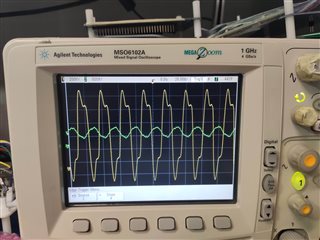

    This is the XTALP (green) and XTALN (yellow) of the IWR6843AOPEVM.

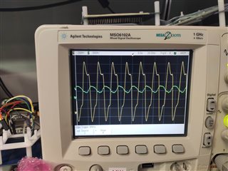

    This is the XTALP (green) and XTALN (yellow) of my board.
    Thanks!
