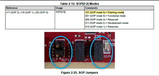

I would like to know on which command to use for the TI system reset, Using the particular command
SYSTEM.RESETTARGET in lauterbach does not bring back the target back to running state. Kindly let me know for some suggestions!

    Please make sure that you have set the right SOP setting to EVM before resetting.
    And please contact Lauterbach team if you are facing any issue while doing reset from the GUI.

    These are the below SOP modes that are currently available in our Setup.
    Could you let me know on where to find the information for SOP to EVM setting?
    Also we populate both SOP0 and SOP1 for the lauterbach connection to be active. If we remove one of them this would interrupt
    the connection to the lauterbach.
    The SOP settings you posted are correct. If you already have flashed the device with binaries then you can operate the device in functional mode to check its working. For this you will only need to populate SOP0. Also can you check once with Lauterbach team if you need to populate the SOP0 and SOP1 at all times. If so then how are you to change to required SOP settings.
