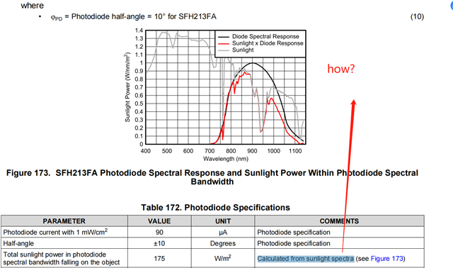

OPT3101: how to calculate "Total sunlight power in photodiode spectral bandwidth falling on the object"

  • Hi Kailyn,
    The total sunlight power in PD is calculated by directly multiplying the two curves of sunlight spectrum and the PD spectral response, ie. for every x point, the y value for both spectra are multiplied and the product is the resulting power for that x point.
