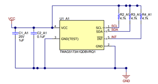

Hi
I want to use the TMA5273 in our new product, but I got stuck by the implementation of the Wake&Sleep mode.
As far as I understand the mode the device will wake up on his own every x seconds, starts a measurement, compare the result and can trigger an interrupt through the INT pin if a treshold will be crossed. After this process the device switches back to sleep and continue.
Hoever I have initialized the device in my firmware, set the sleep time and put the device to wake&sleep mode. But the device will note woken up by an magnetic field. The interrupt function only works when I measure continiously. I need help to find the correct register settings to put the device in Wake&Sleep mode to measure every 20 seconds and trigger and external interrupt through INT to wake my host MCU by crossing a given threshold. I need to compare the settings with my current settings to figure out the problem of my device configuration.
Thank you and best regards
  • Hi Daniel,
    Thanks for posting to the sensing forum. Would you mind sharing your register configurations?
    If your INT_CONFIG_1 register is set to all default values, try setting INT_CONFIG_1 -> INT_MODE to 0x01. This will enable interrupt through the INT pin as the default for INT_MODE is to have no interrupts enabled (see page 30 of the datasheet for more options). Additionally, you'll need to set INT_CONFIG_1 -> THRSLD_INT to 0x01 to enable an interrupt response when a threshold is crossed. You can also set the thresholds for the X, Y, and Z axis as well as for the temperature in Registers 4, 5, 6, and 7, respectively (these registers can be found on page 29 of the datasheet).
    ~Alicia
  • Hi @Alicia,
    please take a look at my code. Maybe you can find the issue in my configuration. In the meantime I will check our comments.
    main.cpp

  • Hi Alicia,
    thank you. I have figured out the issue. I have connected the wrong pin of the 12-pin connector from my TMAG5273EM to my MCU... Disappointed
    I have fixed the issue and the interrupt is generated now, but only when the device is in "Continious" mode. "Wake & Sleep" doesn´t work. I don´t get it...
