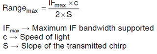

In this equation
Range_max=(3000k*3*10^8)/(2*14.05MHz/us)=32.03m
I set the maximum detection distance to 14.4m, why am I getting this result?

  • 1-1) Our sensing estimator calculates range maximum based on SNR measuring the range maximum at boresight with noise accounted for. The equation you are referring to which results in 32. 03 is an approximation equation for performance in an ideal environment. Learn more in this application note
    1-2) Other parameters in the configuration impact the maximum range. By modifying the CFAR thresholding values you can improve performance. You can find more tips on modifying parameters in the SDK User's Guide or in the 3D People Counting Detection Layer User's Guide (in the industrial toolbox)
    1-3) Maximum distance and maximum unambigous range mean the same thing. However, we have two different equations to approximate these. The equations are both approximation, one ideal and one based on SNR.
    1-4) I would encourage you to compare performance between profileCfg 0 60.5 100 25 69 0 0 50 1 256 6000 0 0 30 and a profile config designed with Fs=300ksps and S=14.05 (something like profileCfg 0 60.5 100 25 120 0 0 14.05 1 250 3000 0 0 30). Ultimately the area scanner STANDARD MMWAVE SDK  COMMANDS command was designed using the approximation equation Range_max=(6000k*3*10^8)/(2*50MHz/us)=14.4m in mind. An SNR based approach (as seen in the sensor estimator) may be more robust and be able to perform better. However, it depends on the enviroment.

  • Hi Kuk,
    I believe what you are missing here is the calculation of IFmax. IFmax is the maximum IF bandwidth supported at your sampling rate. If the sampling rate seen in your equation is 6000ksps then IFmax will have some roll off at either end due to the analog behavior of the signal. This means IFmax needs to be estimated. In our application note that you took the screenshot from it states that IFmax can be estimated by .9*sampling rate. This can be seen in the code for the sensing estimator.
    Range max = max unambiguous range = (.9*6000k*3*10^8)/(2*50MHz/us) = 16.2m
    However, if you look at the datasheet .8*sampling rate is used as a worst case estimator. This is the number I try to use when estimating for customers to be as conservative as possible. Therefore I would say that at 6000ksps you can assume:
    Range max = max unambiguous range = (.8*6000k*3*10^8)/(2*50MHz/us) = 14.4m
    These are both estimations. The best way to get an understanding of device performance is to test. Then by decreasing the frequency slope or increasing the sampling rate you can increase the maximum range of the device.
