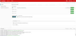

When I try to use Uniflash to flash the xwr68xx_ccsdebug.bin onto the board, it just hangs and doesn't do anything.
The little green light/dot in the corner that is next to Cortex_R4_0 is grey.
