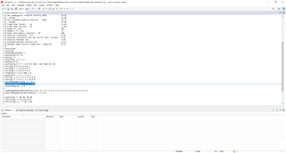

I am using AWR1843boost & DCA1000EVM and have antenna coupling problem(Tx-Rx) .
I want to operate [calibDcRangeSig], But I want to confirm that I am doing well.
Step 1) turn to SOP2(1 0 1)
Step 2) change [profile_calibration.cfg] at CCS (calibDcRangeSig -1 0 -5 8 256   ->  calibDcRangeSig -1 1 -5 8 256)
Step 3) Save the file
I post it what I did.
Does Calibration working well?
Thank you.
  • Hello Hyokbeen lee,
    The configuration looks right. Do run this and let us know if you are facing any other issues.
