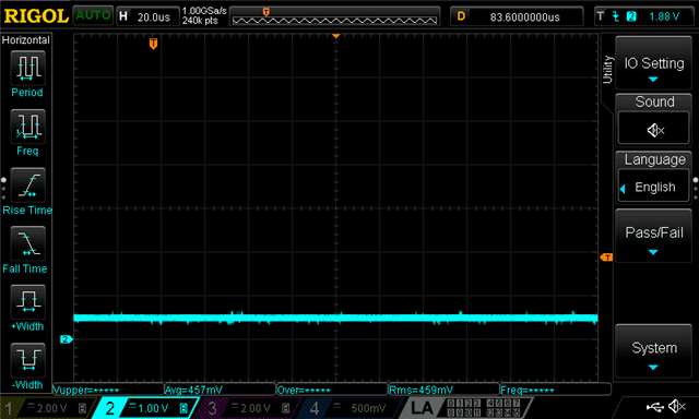

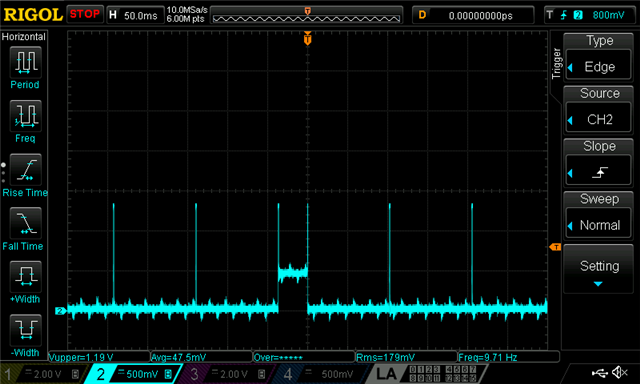

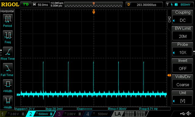

  • Hi Alicia,
    Sorry for the late response, but since measuring the current waveforms (which inserts a 10R resistor inline with the power rail) I haven't seen it fail.
    Interestingly, though, there were times I would short across the measurement terminals in order to switch shunt settings and this would sometimes stop it from working. (Note that the power was never disconnected.) After this the current was about 450 uA which would indicate it is in Standby mode. Given that Standby mode is only entered either from power-up or from a threshold event, could it be that a small change to the power source could cause either of these events. i.e. the operation is sensitive to the power supply rail, causing it to restart or falsely trigger an interrupt?
    The reason I ask is that our product does pulse some indication LEDs which can cause slight dips in the rail voltage due to battery internal resistance, so could also explain why we see the issue. We currently have a 0.1 uF X7R bypass cap right next to the sensor across the power pins and located between the pins and the power rail source.
    As a quick test I'm going to insert a 10R resistor between the power rail and cap to slightly decouple the power to the sensor and see how that works in the product.
    For reference, I've attached some scope traces of operation (W&S, W&S with INT then clear, and what appears to be standby mode). Note that these were taken using the Arduino-controlled test cct. which is more accessible but which did show the issue earlier.
