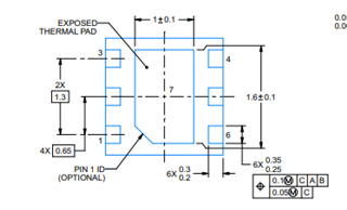

In the datasheet, the exposed pad isn't shown in the recommended land pattern, it's a typo?
Thanks.
Dear Diverger -

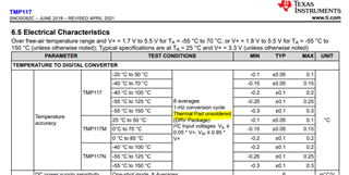

Please see page 41 or 44 in the datasheet, depending on which package variant you are asking about ==> https://www.ti.com/lit/ds/symlink/tmp117.pdf
Hi diverger,
We recommend that the exposed pad not be soldered due to stress and accuracy concerns.
