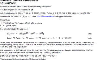

Hi Team,
I would like to know how to correctly calculate the power back-off values as I couldn't find everything I am looking for in the documentation.
This is what is in the document  https://www.ti.com/lit/an/spracp3c/spracp3c.pdf
According to the document, For 6dBm power backoff, the corresponding value should be 0x060606
Appreciate it if you could answer the following questions.
Q1: What does it mean by TXBO = 3,6,9,12 as supported values?
Q2: Can I back off a value such as 6.5 dBm? should it be an integer?
Thanks a lot
