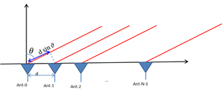

  • Hi, Cagri:
    You can find the following figure explain the phase difference of the neighboring two antennas.
    When the people is standing 45 degree of radar, then the theta should be 45 degree.   In one dimensional case,  the signal phase change between consecutive antenna element can be written as: Δ=2π/λ *dsin(θ) = π*sin(θ), which is 127.2792 in degree; instead of 135 degree.
    Ideally, you should use a point target, such as corner reflector for this testing, instead of using a human for target.  The human will not only occupy only one angle (usually a range of angle), there will be some variation over time due to small movement (like breathing).
    Adding or subtracting 360 degree is always fine.
    Zigang
