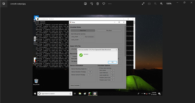

We have problems with our re-build lab project imported from \ti\mmwave_industrial_toolbox_4_12_0\labs\Long_Range_People_Detection  a) the long_range_people_det_6843_demo.bin size is only 401KB compared to the prebuilt binary of 544KB, b) Our built binary has some errors when clicking COMport “Test Connection” using the traffic visualizer in \ti\mmwave_industrial_toolbox_4_12_0\labs\Traffic_Monitoring\gui\tm_visualizer.exe

  • \ti\mmwave_industrial_toolbox_4_12_0\labs\Long_Range_People_Detection  a) the long_range_people_det_6843_demo.bin size is only 401KB compared to the prebuilt binary of 544KB,
    Are you building both the DSS and MSS? The bin sizes should be equal or at least very close to equal if you build correctly. You have to build the DSS, then the MSS.
    A side note, the MulticoreImageGen.exe takes 2 hours to complete the build. Is this normally expected?
    This is not normal either. Are you building with CCS? I would also recommend updating to the most recent CCS build. CCS8 is pretty old.
