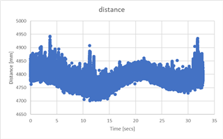

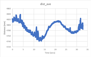

Fluctuation on muddy water
Our customer had collected data on muddy water.
It was a normal flat measurement data most of the time.
But some of the time the measured distance fluctuates like the plot below:
(each point is averaged by 400 samples)
(raw data of distance, ave=2)
The amplitude does not apparently fluctuate while the distance does.
The fluctuation went slowly, with period around 20 secs peak-to-peak and range of 100mm.

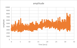

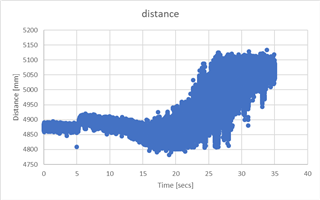

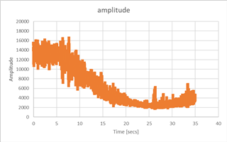

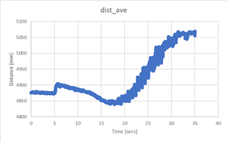

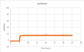

Fluctuation when halogen light strikes directly
They also use halogen lamp lighten towards the sensor directly with distance about 5m.
They have measured the luminance at PD was around 3500lux which was not a very strong light.
They turn the lamp on at 5secs after starting the measurement.
And the plot was as follows:
As the light turned on, the ambient value goes up and stop at a point.
But the distance value goes up and down and then gradually goes up as the amplitude only goes down gradually.
The noise get worse as well after turned on the light.
I was expecting that the distance get stable as the ambient value stabilized, but it did not happen.

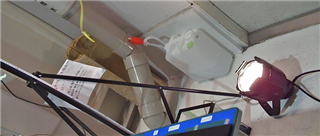

    The basic setup is as the following pictures:
    The sensor is installed at a very long stand around 5m above ground.
    The green led light is the position of the sensor.
    This is the clear water in aquarium tank for measurement taken with IR camera to check the reflected spot of IR beam.
    (The purple glowing area is the IR beam)
    And these are the pictures of halogen setup.
    The sensor is struck by halogen light from bottom.
    The halogen lamp is set on the ground.
    I found that the measured distance fluctuates no mater it is struck directly or get reflected light form target.

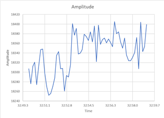

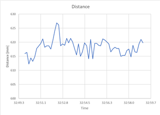

  • The data is stable when measured without exposure of halogen lamp.
    The results of measured data without halogen lamp are shown as follows.
    The target is set at 60cm from the sensor, with data rate= 7~8 Hz, average count= 256.
    The environment and the sensor are both different from the one I've shown above.
    The measured distance fluctuates within +/-10mm or +/-1cm.

    For question 1, with calibration we should not see this fluctuation, especially since the ambient codes are stable.
