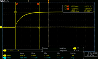

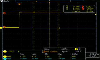

We measuer the VDD wave of board  and find that if we use a fast up 5V power, board always output normal output 0.5V. But if we use a DC supply that have 0.4s power up time , we can easy to copy issue.
Here is VDD wave.

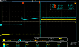

    Here is power wave of SG single signal wave(yellow ) and AVDD wave(bule wave)  .

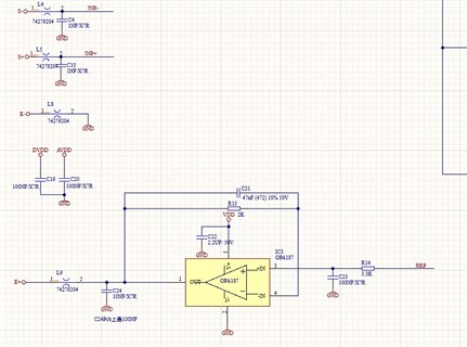

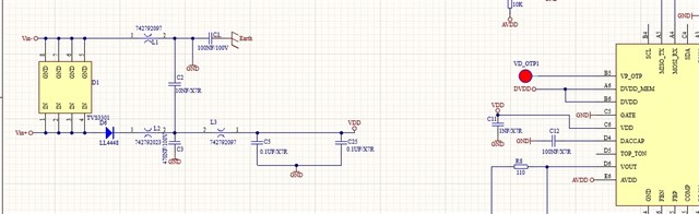

    Here is our VDD and bridge hardware design .
