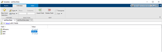

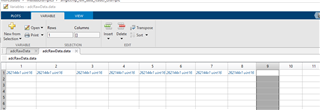

Dear Team,
I capture some data from DCA1000 and saved as .bin file. I used matlab script to change .bin file to .mat file. But I got some error can you help me regarding this. below are the matlab scripts and errors.
