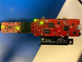

I'm trying to flash the xwr64xxAOP_mmw_demo.bin onto the AWR6843AOPEVM, but Uniflash says it cannot connect to the serial port.
[07/09/2022, 14:33:10] [ERROR] Cortex_R4_0: Initial response from the device was not received. Please power cycle device before re-flashing.
[07/09/2022, 14:33:10] [ERROR] Cortex_R4_0: Not able to connect to serial port. Recheck COM port selected and/or permissions.
To be in SOP flashing mode, I have all switches set to the "down" position except the one on the back (S3) and the top-third one on the front (S1.3). I pressed the top reset button after plugging into the computer and before clicking "load image" in Uniflash.
Trying with S1.3 also down makes Uniflash hang forever on "Opening to COM port".
I am running Uniflash 8.0.0 on Ubuntu 20.04, with sudo so there should be no permission issues.
