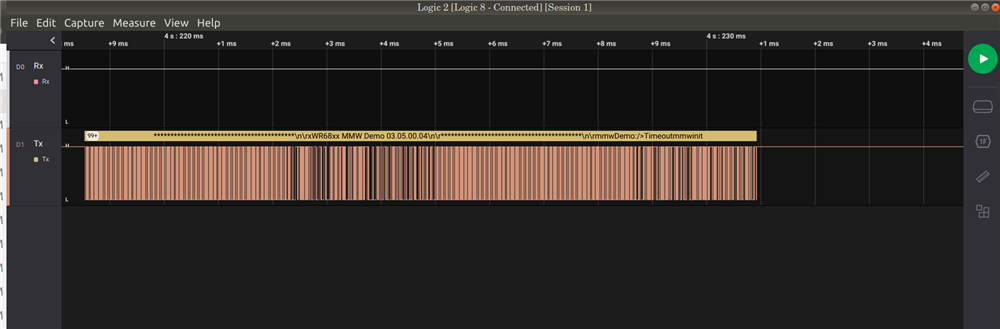

  • Hi Alec,
    Thank you for the suggestion; we tried it, below are our observation
    Modified the mss_main.c to call the function rlDeviceConfigureAckTimeout and passed the argument as 0.
    Built and linking are proper, we didn't get any errors.
    By displaying the logs(timeout) using CLI_Write, we also ensured that the function was invoked. The screenshot is attached for your reference, we used a logic analyzer for viewing the data/logs.
    However, we received the ACK for commands while testing it with the radar module
    Could you point us in the right direction?
