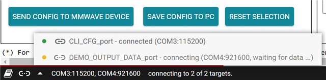

Hi there,
I have recently received my order and trying to get the AWR6843ISK EVM working in a standalone mode (not using ICBOOST now). I successfully flashed the device with xwr68xx_mmw_demo.bin file located in the mmwave_sdk_03_06_00_00-LTS folder. Afterwards the EVM has been set to functional mode and been reset using S2-RST button. After installing CP210x VCP drivers, both COM ports are recognized. Now I use Demo Visualizer in Cloud (with Chrome, Bridge extension added, and Cloud Agent installed) to get some results. After setting the config and the serial ports properly, Demo Visualizer tries to connect to the EVM automatically. When I press “SEND CONFIG TO MMWAVE DEVICE” the CFG port is being connected but DATA port status is “waiting for data” and no results appear in the plot tab (picture is added).
It is worth noting that when CFG port is being connected, D4 (USB enumeration LED) on AWR6843ISK EVM turns on and remains on, see the picture below. Is that OK?
I also tried Tera Term and this is what I got:
Can you please guide me how can I resolve this issue to get the EVM working?
