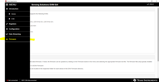

    1 & 2. I used LDC1614EVM board for test this LC Coils(Taxas's LC Coil , My normal inductor capacitor in parallel LC Coil and My PCB LC Coil by Texas LC Coil workbench tool design) I had fine results for one clock time only I didn't test them for long time. I moved to the Code with MicroController I had also fine results for one clock time but When I tested for long time I noticed to Taxas's LC Coil and My normal inductor capacitor in parallel LC Coil worked fine but My PCB LC Coil by Texas LC Coil workbench tool design not. I did firmware upgrade for LDC1614EVM board and it doesn't work now to go back to test them for long time(What is the solution form this problem I connected USB cable to board and did firmware upgrade from LDC1614EVM software tool)

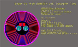

    5. I have to design LC Coil 8mm diaout for my project and capacitor not fit in out of coil Can I put capacitor out of coil
    My circuit is here ... LDC1614 , ceramic capacitors ,40 MHz crystal and my PCB LC coil. My PCB Coil is here

    Thank you for providing those details.  I dont think putting the capacitor within the coils is recommended.  I will see if my colleagues can provide any further insight on why that might be so tomorrow.

    Customer have the EVM however it seems that when he upgraded the firmware the EVM does not work, please see details below.
    I upgraded LDC1614EVM like this document in 2.9 point. I used wrong file for firmware upgrade now EVM does not work. Is there a way also to solved this problem?
    snou135a_USER GUİDE.pdf

    I spoke with our systems engineer and while placing the capacitor in the coil is not recommended, he did not think it would have a significant impact on the performance in this case.
