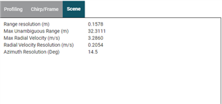

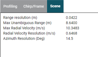

My setting chirp parameter is same but I changed the measurement place.
So unambiguous range is changed.
By the changing the place, is it changed unambiguous range?
Please watch the below figures.

Upper picture:
There is the wall about 6 meters ahead.
Lower picture
There is tha wall about 0.20 meters ahead.
Hi Hiroyuki,
As the conditions is different itself, there will be a change in the max unambiguous range.
If you want to design the parameters for a specific distance, then do go through the documentation given below
Programming Chirp Parameters in TI Radar Devices (Rev. A)
This will give you a better understanding of the parameters of the chirp.
