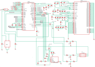

We are going to connect between AWR1843(U2) and TM4C129ENCZADT3(U5) like AWR1843Boost.
Is it OK this connection like a below figure?
*J2 is utilized to install XDS110 Firmware to TM4C129x.

Sorry for the delay. I cannot clearly see the diagrams you have provided, they are very blurry.
You need to connect the signals to the TivaC exactly as is shown in the AWR1843BOOST EVM. Please reference this design and copy as is. As mentioned in the other thread, you need to check with the MCU team if the same firmware will work for both TM4C129ENCZADT3 and TM4C129ENCPDT. The firmware expects the signals to be on the same pins as in the AWR1843BOOST EVM.

understood
I'll try to attach the original file.
Also try sending this to the MCU thread.6825.Schematic.pdf
