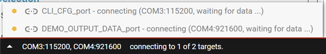

I am using the IWR6843AOPEVM board on a Windows 11 laptop and the TI mmWave SDK 3.6.0 cloud development suite. When I plug in the EVM to my computer with the USB connector, the SDK perpetually says "connecting to 1 of 2 targets..." and the popup menu at the bottom left says "waiting for data..." This seems to go on forever.

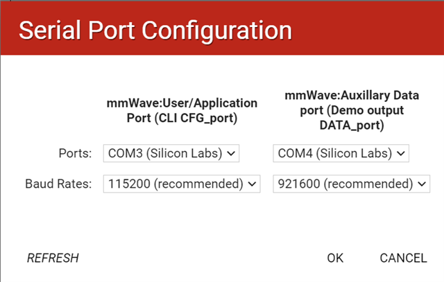

These are my settings in the SDK.

I am not sure what is going wrong here.
    I believe I know the cause of the issue you are facing. There is currently a bug with the browser version of the mmWave Demo Visualizer that we are working to resolve. Please see this thread for help finding the offline version of the tool.

    I downloaded mmWave Demo Visualizer to my computer. I am no longer using the browser. However, the exact same issue persists. It keeps saying "connecting to 1 of 2 targets..." in the bottom left corner. I am using the same settings that I was using on the web version.
    Could this be a hardware issue? I am unable to find a specific baud rate for COM3 and COM4 on the datasheet for the IWR6843AOPEVM. The datasheet also mentions something about using Uniflash to flash the EVM. Do I need to do this before connecting with the mmWave visualizer?
    Yes, the device must be flashed with the Out-of-Box (OOB) demo binary before connecting to the visualizer. Instructions for using Uniflash to flash the mmWave EVMs can be found here.
