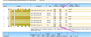

As shown in the figure, if the processed thickness of the copper foil of the Layer 1 and Layer 6 cannot reach 2.067mil, just reach 1.4mil, will it have any effect?
Hello Nicky Liu,
Finished thickness of 1.6mil/1.4mil would be good target.
