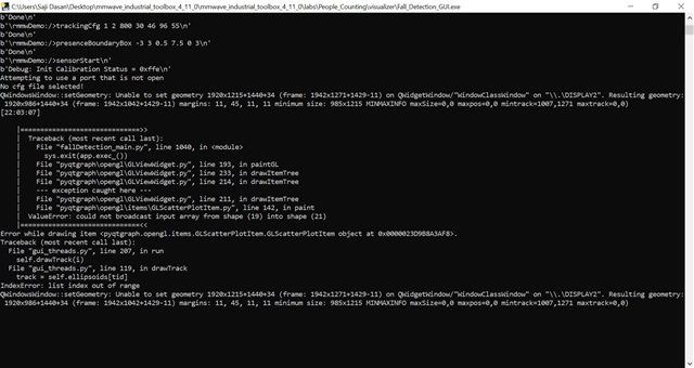

I am trying to test the device for a fall using the Fall_Detection_GUI provided by TI.
I am able to connect and the Visualizer is detecting the device and radar signals, but unfortunately it is not detecting a fall.  I am not sure if its some settings that I need to change.
It seems to throw a "Out of Bounds" error.
Thanks!

  • Nate - Thanks for your help. The Firmware I am using is "3D_people_count_68xx_demo.bin"....this is from the mmwave_industrail_toolbox_4_11_0.........in labs->People_Counting->3D_People_Counting->prebuilt_binaries folder
    The  configuration file being used in the Visualizer GUI is "ODS_6m_smallRoom.cfg"
    This error is comping from the radar device, from the windows terminal when I run the "Fall_Detection_GUI" in the visualize folder in the toolbox.
    Appreciate your help and please let me know if you have any other questions.
    Saji

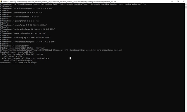

  • Nate - Thanks for your email. As per your suggestion, this time I used the "AOP_6m_default.cfg" config file in the Fall Detection folder. (but no chaange from previous error)
    Attached are the screen shots of the Visualizer and the error I was referring to. First I get the "divide by zero error" and the "index out of range"....These errors happen after a minute or so, but even before that no fall is detected.

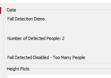

  • Hi Saji,
    I can look into this in greater detail tomorrow. In the meantime though - I do notice that your screenshot includes the following, which indicates to me that you can only run fall detection when only 1 person is detected. Perhaps you can retry with just a single person detected?
    Nate
  • Nathan - I am not sure why it shows two people, That happened many times, even though I was the only person in the room, it shows more than one person. Is it something to do with how I am positioning the device?

  • Nathan - While I tried to retest, I came across this error now, different from before and seen it before as well, but thought Ill share with you.
    Thanks!
    Saji

  • Nate - Please see the defect image I had sent previously, that's the defect I get always. First I get the "divide by zero error" and the "index out of range"....These errors happen after a minute or so, but even before that no fall is detected.
    I retested with the correct COM ports and it shows "Connected" as well, followed by the above error.
    If possible could you please send me a link (or attachment) of the binary and cfg I need to use? I have provided above the ones I have used.
    Also is there any settings I need to change on the GUI?
    Saji
  • Hi Saji,
    Sometimes I get these errors too, but they don't stop the visualizer from running. When I use the 4.11 toolbox versions of:
    1. C:\ti\mmwave_industrial_toolbox_4_11_0\labs\People_Counting\3D_People_Counting\prebuilt_binaries\3D_people_count_68xx_demo.bin
    2.  C:\ti\mmwave_industrial_toolbox_4_11_0\labs\People_Counting\visualizer\fallDetection_main.py
    3. C:\ti\mmwave_industrial_toolbox_4_11_0\labs\People_Counting\3D_People_Counting\chirp_configs\AOP_6m_default.cfg
    It works without an issue. It triggers when I fall.
    Do you reset the device between uses? That may also cause the port open problem you mentioned above.

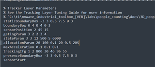

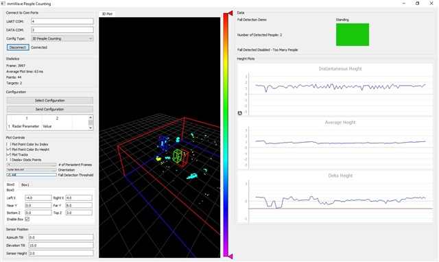

  • Hey Nate - its so surprising, I am using the exact the same files you mentioned above,  and just tried this multiple times, still no luck. Is it something to do with how you place the device or the antennae....at what height are you placing the device?
    It turns red randomly, there is no consistency at all.Could you please send me a snapshot of your visualizer settings - maybe that is different.
    What is your "Fall_threshold" setting...mine is -0.22
    Really appreciate you trying to help me, Am really hoping to get this working soon.
    Have a nice evening!
    Saji
  • Hi Saji,
    You will need the sensorPosition information to match your sensor's placement. This cfg parameter is documented in the people counting documents here.
    https://dev.ti.com/tirex/explore/node?a=VLyFKFf__4.12.0&node=AHZY4H1u04B21l9zTRElvQ__VLyFKFf__4.12.0
    You should also see point cloud output that corresponds to your movement. Do you not?
    Nate
  • Hi Nate - Thanks for the info. No, I had not updated or changed the Sensor Position Information anywhere. Do I need to update  these values in the visualizer GUI?
    If so could you please let me know the fields in the visualizer, that I need to update? I want to make sure that I don't make any mistake.
    Thanks!
    Saji
  • Hi Saji,
    This gets modified in the cfg file that gets sent to the radar device. See the sensorPosition line.
    Nate
