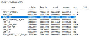

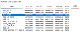

Could you pls elaborate why TCMB of AWR2944 is not used in sbl_qspi & mmw demo.
  map file of sbl_qspi
 map file of mmw_TDM
My questions are as follows:
1.Is TCMB reserved for specific use?
2.Why the size of TCMB is different in below map files?
3. TCMA is only used for vectors, could I use rest of TCMA for codes?
