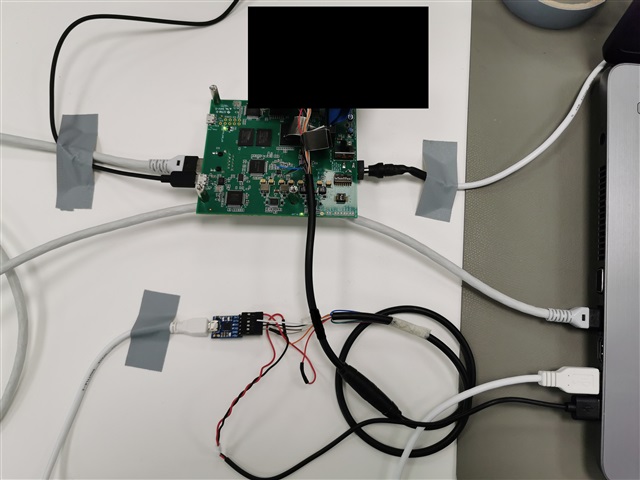

we are trying to use mmWave Studio with a custom PCB with the IWR1843 SoC. The issue I am facing is that RS232 connection can not be established ("Error: Connection failed: Calling_ConnectTarget returned 3"). I have read similar posts on this forum but could not find a solution for this issue. I have also followed the hints from the DCA1000 debugging guide with no success.
  •  The custom PCB has the required high density connector to connect to the DCA1000, identical to the IWR1843BOOST EVM. All required connections to IWR1843 as described in the hardware design checklist are present. RS232 RX/TX lines are not connected on the high density connector, the same as on the IWR1843BOOST.
  • The RX/TX lines (Ball N4 and N5) and GND from IWR1843 are connected to an (external) USB-UART bridge ( Silabs CP2102) which connects to the PC.
  •  Flashing of the IWR1843 using Uniflash works fine using this setup, therefor I assume there are no connection issues. The COM port is also accessible using a serial terminal.
  •  SOP0 and SOP1 are connected to 3.3V, SOP2 is pulled to GND.
