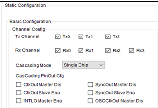

I have read the document named “Mmwave Radar Device ADC Raw Data Capture (Rev. B)”. In this document, it describes the readDCA1000.m for IWR6843. However, using that script, it does not allow for virtual antennas (Ntx * Nrx). So even when I have 2 or 3 Tx with 4Rx, I have just 4 channels from my receiver. How do I get the full (Ntx*Nrx) virtual antenna array?

    Which script are you using currently to run raw ADC data capture? When manually setting up the run configuration in mmWaveStudio, under the StaticConfig tab you can turn on/off whatever antennas you want. If you'd like, you can click one of these buttons and then go to the "Output" tab to see exactly what parameter this corresponds to so that you can make the adjustment in your script.
