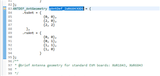

  • Ok, but the different antenna definition also lies inside the ODS objectdetection.c and not in the antenna_geometry.c, contrary to what is suggested in this forum.
  • I see an antenna definition in antenna_geometry.c in the ODS project in toolbox 4.12.
  • Yes, it is also present in the ISK board. In the ODS code it gets loaded inside the static config struct which is then transferred with the DPU_AoAProcHWA_config(dpuHandle, &aoaCfg); method. But if you open the doxygen files for this method, the value antDef is not used anywhere in the config method itself. And as mentioned above, the doxygen for the static config struct says that its not used and only implemented for future use. If I got that wrong, I would be very happy if you could point me to the method which uses the antDef property.
    If you're trying to understand how to modify the ISK out-of-box demo to run on the ODS, then I would suggest you look into the aoaprocdsp.c file under SDK/packages/ti/datapath/dpc/dpu/aoaproc/src. In the AoAProcDSP_processMultipleVirtualAntennas function, you will see how the angle FFT is computed for this demo. It looks like the antenna layout is accounted for by the way the FFT samples are stored in the L3 memory in this demo, so it may not be very easy to modify it for ODS. For what you're trying to do, I would recommend using the ODS project as a starting point.
