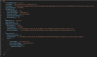

Hello Team,
I got an error of "Not enough input arguments.
Error in rawDataReader (line 163)
if(debugPlot)"
and my Matlab script of "C:\ti\mmwave_studio_02_01_01_00\mmWaveStudio\MatlabExamples\singlechip_raw_data_reader_example" is:
% Start example UI and update time domain/range Profile plots
if(debugPlot)
% Start up processing display page
ui.figHandle = initDisplayPage(setupJSON.mmWaveDevice);
% load and Plot the first frame
dp_updateFrameData(1);
ui_updateFramePlot();
% Wait for UI interactions
while (~EXIT_KEY_PRESSED)
pause(0.01);
end
close(ui.figHandle);
end
%close and delete handles before exiting
for idx = 1: numBinFiles
fclose(Params.fid_rawData(idx));
end
close all;
end".
Please help me how to remove this error.
My second question is this the result of raw data by name of "rawDataFilename.mat" but I got 1x2047 mat files and how I can identify which is my raw data or all the files are the raw data and I can combine them in 1 file. I'm bit confused about it.
My third question: from the output of mmwave studio I got 6 bin files. Then I used the matlab script as mentioned above. so the results means that mat files are the combination of 6 files of just 1 file as mentioned in
16xxsetup.json file as attached with this thread.
all files are attached please have al look.
Thank you.
Kind Regards,
Fahad Ayaz

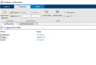

  • Hi Cesar,
    No worries at all. Thank you for your response.
    > Actually I'm able to get raw radar data through mmWave studio. Also post processed data as well.
    >  I have two questions related to this.
    1) When I used the script as provided path below and run the matlab script and provide the bin file and conf file(setup.json and mmwave.json)  it gives me 2 mat files (a) rawDatafilename.mat and (b) rawDatacube.mat. Also with an error of as mentioned above (If Debug File Error). So first question is how I can remove the error?, to get the plots.
    2) As attached above figures: These are the figures from mat files which I discussed in Q1. So my second question is as you see in mat files I have diferent results some are: rfParams, Data and dim.
    I know about the two but the third one which is Data when I open it, it gives me several variables as shown above ( adcVariablesdata.data) so my question is I'm confused about these several files which belongs to which category and how I can manage it by combining all these files together or what else I can do?
    I hope you understand now.
    Kind regards,
    Fahad
    The readme file shows an example how to call this matlab script. Are you providing all arguments?
    C:\ti\mmwave_studio_02_01_01_00\mmWaveStudio\MatlabExamples\singlechip_raw_data_reader_example\readme.txt
    Based on the matlab script, one can see the content of the rawdata. As you can see the data is the rawADCData that was read from the bin file.
    thank you
    Cesar
            adcRawData.rfParams = Params.RFParams;
            adcRawData.data = rawADCData;
            adcRawData.dim.numFrames = Params.NFrame;
            adcRawData.dim.numChirpsPerFrame = Params.adcDataParams.numChirpsPerFrame;
            adcRawData.dim.numRxChan = Params.NChan;
            adcRawData.dim.numSamples = Params.NSample;
  • Hi cesar,
    I think you didn't understand my questions properly.
    > I don't know which argument I should provide to remove the error???
    > I know that is the RawAdcdata. But you can see in figure I have different variables under Rawadcdata.mat file. Which one is my Rawdata all of these 262144x1 all these files are my data or I can emerge them?
    Thank you
