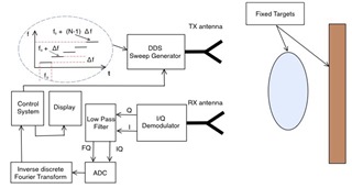

Hi Team,
Good day! Could you please check our cusotmer's concern below?
Here is the scematic of our proposed system below. In the manual it is mentioned I need to have DCA1000EVM.I do not have DCA1000EVM board. Do I need it ? Also, if it is not possible with AWR1642 could you provide the name of the board? So we can order it.
I will emulate SFCW behavior by setting a zero slope in profile config and using a delta start frequency for each subsequent chirp.
