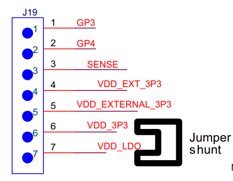

  • Hi Christian,
    Do you have the jumper connected like so on J19?
    Thank you,
    Brent Elliott
  • Hi Elliot,
     Yes I do, it came stock like that from Digikey.
    Thank you,
    Christian Garcia
