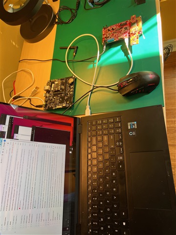

I have a setup consisting of IWR6843AOPEVM + MMWAVEICBOOST connected to a computer running Ubuntu 22.04 LTS.
I have flashed the EVM  with out-of-box demo using the pre-built binary out_of_box_6843_aop.bin from ~/ti/mmwave_industrial_toolbox_4_12_0/labs/Out_Of_Box_Demo/prebuilt_binaries . I did this using the UniFlash tool.
I was able to launch the demo visualizer tool (not the browser version) and connect to the target system.
However, I am not able to run the out-of-box demo.

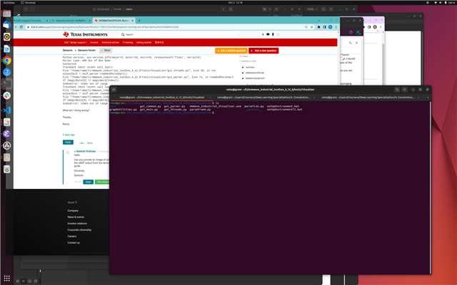

Here is the console output:
rama@gram:~/ti/mmwave_industrial_toolbox_4_12_0/tools/Visualizer$ python3 ./gui_main.py
Warning: Ignoring XDG_SESSION_TYPE=wayland on Gnome. Use QT_QPA_PLATFORM=wayland to run on Wayland anyway.
Python is 64 bit
Python version: sys.version_info(major=3, minor=10, micro=6, releaselevel='final', serial=0)
Parser type: SDK Out of Box Demo
Connected
Traceback (most recent call last):
File "/home/rama/ti/mmwave_industrial_toolbox_4_12_0/tools/Visualizer/gui_threads.py", line 40, in run
outputDict = self.parser.readAndParseUart()
File "/home/rama/ti/mmwave_industrial_toolbox_4_12_0/tools/Visualizer/gui_parser.py", line 74, in readAndParseUart
if (magicByte[0] == magicWord[index]):
IndexError: index out of range
What am I doing wrong?
Rama
  • Hello.
    Can you provide an image of your current set up as well as the current list of ports in your device manager?  It looks like the GUI isn't able to parse the UART output from the device so please also make sure that you have the correct UART drivers installed that are provided in the out of box user guide.
    Sincerely,
    Santosh
  • Hi Santosh,
    Above images show my setup. As I noted before, UniFlash was able to recognize my set up. And after I made the suggested in https://e2e.ti.com/support/sensors-group/sensors/f/sensors-forum/1137996/iwr6843aopevm-connecting-mmwave-industrial-visualizer-to-target-on-ubuntu?tisearch=e2e-sitesearch&keymatch=UBUNTU# I was able establish connection from the Visualizer to the board. Let me know if you need any other information about my setup.
    Rama

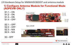

  • Hello.
    According to your setup, it looks like the S2 switches on the AOP are incorrect as they should be OFF/ON/N.A/N.A for S2.1/S2.2/S2.3/S2.4, respectively.  However, all of your switches are in the OFF position.  It also looks like you are still in flashing mode instead of functional mode based on the jumpers on the ICBoost, but the picture was a bit blurry when I zoomed in so please correct me if I am mistaken.  Please reference the EVM setup guide for how to do this with the ICBoost, linked here.  Also for some clarification, does this error occur after you press the connect button or when you send the cfg?
    Sincerely,
    Santosh

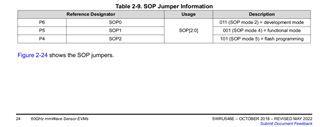

  • Hi Santosh,
    I did the switch setting watching the video at https://training.ti.com/hardware-setup-mmwaveicboost-and-antenna-module  and this is what I saw at 9:30 mark:
    Here is the SOP jumper setting:
    Looking at the documentation
    I feel the jumper setting I have corresponds to 001 (SOP mode 4) = functional mode
    This is what I see in SWRU546E page 72 for S1 and S2 setting on IWR6843AOPEVM:
    Now I see the difference. So, should S2.2  OFF for flashing and then set to ON for functional mode? I thought the only thing that needs to be changed from flashing mode to functional mode was SOP2 jumper setting. on MMWAVEICBOOST board. Can you please clarify?
    Rama
