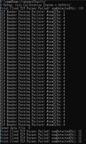

  • Hi, Nate,
    Now I can save out the point cloud data in csv file finally.
    However, after I retry this lab twice time again, it still output error messages, which looks very similar in both tries, following figures are the my description:
    1. I modified 2 python source codes according to the "TLV Header Parsing Failure" and "Point Cloud TLV Parser Failed" to show the current variable values:
    2. The error messages while lab is running and saving csv file are:
    My questions are:
    1. It seems that both 2 Parsing Fail error happen once in a while, are those errors related to the missing TLV header data during UART is transferring? Or even the FW even don't transfer the TLV header data in these specific frames? (Because most of them belong the the 4th numTLVs.)
    2. "Point Cloud TLV Parser Failed" happened after the file starts to write, and "TLV HeaderParsing Failure" happened before it. Are these two errors are related to the same reason?
    3. I found there is very few missing frames in the csv file, (this also happens once in a while and not in every save files.) is this the root cause of the error messages?
    Thanks.

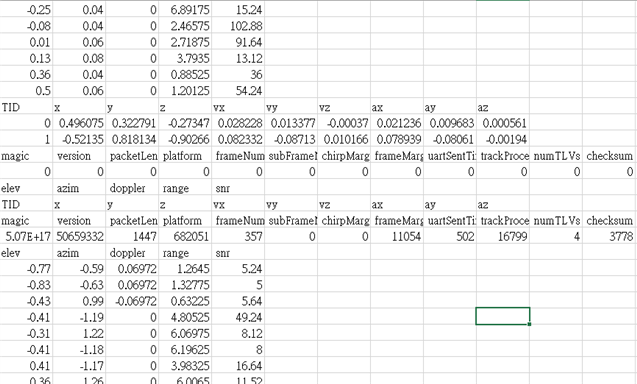

  • Hi Nate,
    I have re-run the setUpEnvironment.bat script to make sure those 5 libraries have been correctly installed already.
    I did not run anything else at the same time, and also use the cable which was original equipped.
    After checking the contents of saved csv files, I found that there are some un-expected values as following figure:
    => It appears all zeros of the decoded frame header structure!
    Is this to be the root cause of the error message?
    Shihyu.
  • Hi Shihyu,
    How did those csv files get generated? Those appear to be generated by the saveTextFile flag. Please turn this flag off and only save the binary. This is what I do. If this does not generate any errors, I can give you a script to decode the binary into a readable format.
    Nate

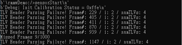

  • Hi Shihyu,
    The picture you have shown above indicates to me that the visualizer is failing about every 200 frames, is that correct? If so, I think the problem is likely with the compatibility between the visualizer and your computer, and I would suggest just using the data that it's giving, seeing as it only loses one frame out of every 200.
    Nate

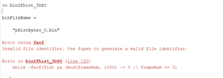

  • Hi Nate,
    I saved some of the data as shown below through set self.savebin file flag to 1. But I have a question what does this so many file means by name of phistbytes?
    Second question is that I put all details in matlab script is this correct as shown below.
    Third question I ran the script and got an error and also .mat file is empty shown below.
    Last question is: Can this script is also useful when I collect UART data through tera term and then parse through script is it work? or Data through DCA1000 or data through the above suggestion when we set flag of savebin file to 1.
    Your help is highly appreciated.

  • Hi Fahad,
    Please review the code before posting questions online. In the python code, you will see that every 1000 frames (or whatever number you set to) the code saves a file of the previous 1000 (or however many) frames.
    This looks like a bad file path. You can debug it in MATLAB. You may be missing a backslash or you have an extra one in your filename.
    This script will also work on data taken through a serial tool like tera term, but it does not support the DCA1000 data output.
    Nate

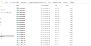

  • Hi Nate,
    It means if I set 10 frames so it gives me 10 pHistbytes_0.bin files. From pHistbytes_0 to pHistBytes_10 right?
    You cannot give me my second question answer also attached here. Is this correct? I just made these changes.
    So I attached my filename above and also please clarify it more to me please. I tries by adding and removing the backslash in the above filename and file path but the same error I got.
    > Please also help me about the different bin files as given in question 1 above. How I can parse them and get readable results.
    Kind regards,
    Fahad
  • Hi Fahad
    This is not correct. If you set to 10 frames, then the file will save every 10 frames, and you will have pHistBytes files containing 10 frames each, with a number that depends on how long the sensor runs for.
    I suspect it's a compatibility issue with your computer. You will have to see if the file exists in the path that the script searches for it. This is not a script that we provide product support for, as it's just used by me locally to parse my own data. Hence, you will have to port it to your own system.
    Nate
  • Hi Nate,
    Thank you for your response.
    Alright I understand now, it means I got 20 different files with name of pHistBytes.bin and all these files contains 10 frames of data each. After every 10 frames it creates 1 bin file right? and it depends how long sensor runs and creates a bin files that contains 10 frames of data and so on.

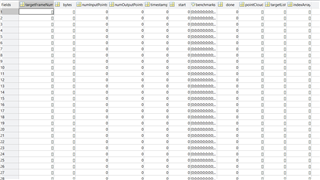

  • Hi Nate,
    As from the above error I solved it but again found a new error which is:
    Index exceeds the number of array elements (0).
    Error in bin2fhist_3DPC (line 123)
    magicBytes = typecast(uint8(rxHeader(1:8)), 'uint64');
    I tried it alot but never solved it.
    kind regards,
    Fahad
  • Hi Fahad,
    As I said before, you will need to debug this script yourself if it does not work as expected, as it is not a part of our supported collateral. I am closing this thread now as it has drifted well beyond the initial inquiry.
    Nate
