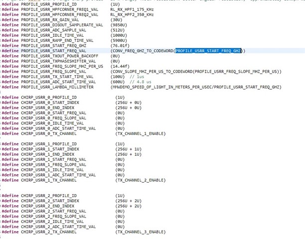

I am using IWR1443Boost and DCA1000. I have used mmWaveStudio GUI to configure the chirp. But I am not aware of the accessing location/file to define the chirp configuration like the below image(image belongs to a user thread).
Which location/file to access in order to define the chirp configuration?
Please suggest any documents that guide the same.
