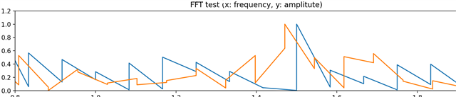

    No, I am asking whether TI engineers are sure that if a person's breath rate goes to zero during holding a breath also represents the presence of heart rate. If not, then whats the sign to check heart data is being detected by the radar?
    Based on my research experiences using different company radars, I found that detection of breath rate does not guarantee the detection of breath rate in spite of the company's claim to detect heart rate. See the below image. I collected the data using an ECG sensor and radar. Then I plotted the data into the frequency domain, you can see frequencies of ECG and radar at different locations. As per the Fourier series, each frequency appears with a single peak in the frequency domain.
    The orange color signal is an ECG signal, and the blue is a radar signal. The X-axis represents time and Y axis power.
    Since I wasted my long time. I wanted to make sure whether TI radar captures heart data. Hope you understand.

  • Hi Arjun,
    We verify the accuracy of our heart rate data by comparing with heart rate measuring devices such as pulse oximeters. We find that our heart rate estimates are +/- 5bpm in accuracy in our latest labs. We see an improvement in our heart rate data form our IWR1443 device when it is used with a radar lens to focus the signal onto the heart.
