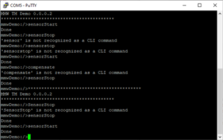

    I already done Option A. I work like this :
    1. Import Level sensing labs in CCS.  I got 2 folder : high_accuracy_16xx_dss & high_accuracy_16xx_mss
    2. Building setting set to SDK3.6 on both high_accuracy_16xx_dss & high_accuracy_16xx_mss.
    3. I got porting guidance (SDK 2.0 to SDK 3.6) from this forum , so I follow then
    Add 3 header file from mmw demo : mmw_config.h, mmw_outout.h, detection_object.h to MSS/common, DSS/common
    Change path mmw_config.h to common/ mmw_config.h
    4. Add compensation function in dss/mmw_cli.c
    Result :
    - with high accuracy visualizer 2.1 (support SDK 3.6)  > I got no point-cloud
    - with putty : I can type cli mmwave ex : sensorStart, and got response

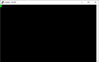

    1. Import Out of box demo labs in CCS.  I got 2 folder created : out_of_box_1642_dss & out_of_box_1642_mss
    2. without doing any change, I compiled and flash out_of_box_1642_lab.bin.
    Result :
    - demo visualizer show nothing
    - with putty : no response

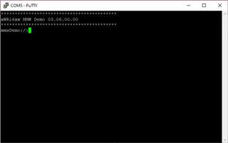

    that's interesting.
    Out of box demo bin result = mmw demo , correct ?
    If I flash mmw demo 16xx bin file, it worked normally as usual.
    Both on putty and mmwave demo visualize 3.6.
    To make more detail, which file I should post here ? .project file ?
    You mention what you have working on Option A, although I see that the CLI banner mentions the TM demo, which I assume is from of one of our older Traffic Monitoring demos. Did you modify this banner? Or is this perhaps an indication that the proper code is not being loaded properly? Additionally, if you are not seeing any CLI input, you can debug in CCS to see where the error may potentially be.
    Alec
  • No , it come from mss/cli.c file of High Accuracy / Fluid Sensing
    my path C:\ti\mmwave_industrial_toolbox_4_10_1\labs\Level_Sensing\src\16xx\radarDemo\chains\RadarReceiverHighAcc_mmSDK\mmw_HighAccDemo\mss

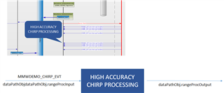

  • After deep comparison to SDK 3.6 demo source code and SDK 2.1 demo source. I have question,
    SDK 3.6, in DSS mmw \ dss_main.c : DPC_ObjectDetection_chirpEvent is callback for Chirp event in below flow chart.
    My question , compare to SDK 2.1, DSS mmw \ dss_main.c :
    this call back similar with MMWDEMO_CHIRP_EVT in MmwDemo_dssDataPathProcessEvents() correct ?
    static int32_t MmwDemo_dssDataPathProcessEvents(UInt event)
        MmwDemo_DSS_DataPathObj *dataPathObj;
        volatile uint32_t startTime;
        dataPathObj = &gMmwDssMCB.dataPathObj;
        /* Handle dataPath events */
        switch(event)
            case MMWDEMO_CHIRP_EVT:

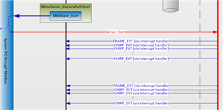

    Below is SDK 2.1 chirp event flow chart :
    I still work on porting High Accuracy SDK 2.1 to SDK 3.6. I want to add
    High accuracy \ dss_data_path.c : MmwDemo_processChirp()
    High accuracy \ dss_data_path.c : MmwDemo_interFrameProcessing()
    to Out of Box \ dss \ objectdetection.c : DPC_ObjectDetection_chirpEvent ().
    Any opinion about this ?
    my plan is to add Zoom FFT on that Chirp Event arise in SDK 3.6
    This seems like the correct approach. Let me know if you have any questions.

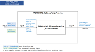

    as I researched High Accuracy Lab implementation into MMW Demo SDK 2.1 , I make summary like below
    Each time Chirp Event arise, it will invoke above RADARDEMO_highAccuRangeProc_run() and ADCBuf input will be processed with Zoom-FFT.
    Is that correct ?

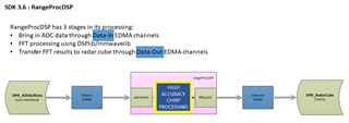

    Then, I plan to port this High Accuracy Block RADARDEMO_highAccuRangeProc_run() to MMW Demo SDK 3.6 at Chirp Event DPC as below :
    Best way to port RADARDEMO_highAccuRangeProc_run() is inside mmw demo rangeProcDSP block (between adcDatain and fftOut1D).
    it's located on file dss/objectdetection.c , function : DPC_ObjDetDSP_rangeConfig() Line 572
        /* hwres - adcDataInSize */
        hwRes->adcDataInSize = 2U * staticCfg->numRangeBins * sizeof(cmplx16ImRe_t);
        hwRes->adcDataIn = (cmplx16ImRe_t *)DPC_ObjDetDSP_MemPoolAlloc(CoreL1RamObj,
                                                      hwRes->adcDataInSize,
                                                      DPU_RANGEPROCDSP_ADCDATAIN_BYTE_ALIGNMENT_DSP);
    Is this correct approach ?
    But I found something mismatch : RADARDEMO_highAccuRangeProc_run(input_signal , output_signal) input_signal is cplx16_t.
    Can I made hwRes->adcDataIn with data_type cmplx16ImRe_t as input_signal to RADARDEMO_highAccuRangeProc_run() ?
    It is a bit challenging to give guidance on very specific changes such as this, without trying it myself. However ,at a high level, your approach still makes sense. I would recommend that you continue to try to implement this, and if you encounter any specific issues, we can discuss further and I can provide guidance.
    Alec
