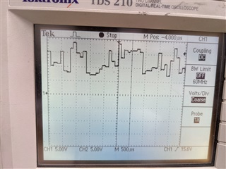

I'm having an issue with the excitation of a PGA970 on an evaluation board.  The excitation was a nice sine wave and while attempting to test the loop back function, the waveform became erratic, see below.

  • Hi Alex,
    Just to clarify, after the opamp was removed you are seeing the digitized-looking waveform from the first post? And the waveform data table has not changed at all between when you were able to get a clean sine wave and now? Have you noticed if the current draw from the EVM is any different from when the waveform looked correct? And can you check the voltages on AVDD and DVDD? Also, please check the PI/PE pins with a scope.

  • Correct, the digitized waveform was with the op amp removed.  I haven't changed the waveform table and the current draw went up a little bit, maybe 10mA initially.  Checking it now, the current draw appears to be the same.
    AVDD- 2.977 VDC
    DVDD - 1.851 VDC
    The PI and PE pins show a digitized waveform as well.  I don't currently have an LVDT to test S1 and S2 without the loopback.  Also, I'm not sure I was ever able to get the loopback working properly.  That is what I was attempting when the excitation went from a sinewave to digitized.

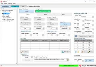

  • It seems like the device isn't experiencing any power issues. Have you checked if the waveform RAM has been successfully populated with the data from the table? You can see this on pages 8-9 in the Data/Waveform RAM section of the GUI, and compare to the table that is populated on the ADC page.
    Scott
  • Pages 8 and 9 read almost all 202s.

  • Hi Alex,
    The 202s don't match the table on ADC settings page. Can you try writing those values back into RAM, disabling generator and re-enabling it again? I can't remember if you need to take the device in and out of Microcontroller mode to get everything copied over and enabled but try that as well. We need to have the new values put into RAM and then pulled out of RAM to set it.
