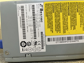

  • There are no other peripherals plugged into the computer and the Ethernet is directly connected without a dongle.  I've tried different cables as well.  At this time, we are interested in the lower level raw ADC data. The first error I experience following the instructions is:  Unable to read FPGA Version. [error -5]
  • ...I also already flashed new firmware and I am using a power supply with more than enough amperage (30A) to power the DCA1000.
    Could you take some pictures of your hardware setup? If everything looks in order to me then we can proceed with more debugging help or other options.
    Pedrhom Nafisi
    Everything looks to be in order in the pictures. Since your hardware switch configuration is correct, have ample current power supply, have direct connections from DCA1000 to your computer, have tried different cables, have no other peripherals connected, tried reflashing the FPGA via Lattice tool, and have all required driver installations, I would try a different computer if possible as well as try fully uninstalling mmWaveStudio and reinstalling it. If this does not work then contact customer support and give them my name and I can vouch for your physical return.
