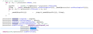

  • Hi Alec,
    Yes, we did calibration using Out of Box demo. But when we apply the calibration result to iwr1642's people counting, it is clear that the people counting can't process the compRangeBiasAndRxChanPhase when we send the cfg via uart. As contrast, when I run the iwr6843's people counting, it is running the compRangeBiasAndRxChanPhase, and we can see the different between using the calibration result, and without using it.
    We can even see at cli.c https://dev.ti.com/tirex/explore/node?a=VLyFKFf__4.1.0&node=A__ADHEd0FHCCOv2zu5jdRGWw__com.ti.mmwave_industrial_toolbox__VLyFKFf__4.1.0 of this people counting, there is no command for compRangeBiasAndRxChanPhase.  I tried to change the cli.c, but for no avail
    Any idea how to fix this problem?

    Wolfgang
  • Wolfgang,
    As you mentioned, you will likely need to update multiple files. You should almost certainly begin with the CLI source files, since that will be the first piece which will interact with the command. If you have any specific questions or issues, let me know.
    Alec
  • Understood, and I will try to deep dive the codes.
    Thank you very much.
    Wolfgang
  • Hi Alec,
    I have changed some codes, including cli.c, dss_main.c, and lastly radarProcess.c (and radarProcess.h). My question is, in the radarProcess.c ,line 391 there is phase error compensation process. In this process, there is 2 variable,, l1temp and inputptr,, but I can't see where this two variable is send to. Can you helping me in solving this question, that I believe is relevant to this thread topic.
    Thank you very much,
    Sincerely,
    Wolfgang

    	/* phase error compensation*/
    	for (i = 0; i < processInst->nRxAnt; i++)
    		inputPtr	=	(int64_t *) &pDataIn[i * processInst->fftSize1D];
    		lltemp	=	_itoll(_amem4(&processInst->antPhaseCompCoeff[i]), _amem4(&processInst->antPhaseCompCoeff[i]));
    		for (j = 0; j < (processInst->fftSize1D >> 1); j++)
    			_amem8(&inputPtr[j])		=	_dcmpyr1(_amem8(&inputPtr[j]), lltemp);

        timeStamp   =   timeStart;
        benchmarks->bufferIdx++;
        if (benchmarks->bufferIdx > benchmarks->bufferLen)
            benchmarks->bufferIdx = 0;
        return status;
    int32_t processDelete(void *handle)
        radarProcessInstance_t *inst = (radarProcessInstance_t *)handle;
        //EDMA3_DRV_Result edma3Result = EDMA3_DRV_SOK;
        RADARDEMO_rangeProc_delete(inst->rangeFFTInstance);
        RADARDEMO_detectionCFAR_delete(inst->detectionInstance);
    	RADARDEMO_aoaEstCaponBF_delete(inst->DoAInstance);
        radarOsal_memFree(inst->rangeProcInput, sizeof(RADARDEMO_rangeProc_input));
        radarOsal_memFree(inst->localPDPPtr, inst->fftSize2D*sizeof(float * ));
        radarOsal_memFree(inst->localPDP, inst->fftSize2D * inst->fftSize1D * sizeof(float));
        radarOsal_memFree(inst->detectionCFAROutput->rangeInd, inst->maxNumDetObj *sizeof(uint16_t ));
        radarOsal_memFree(inst->detectionCFAROutput->dopplerInd, inst->maxNumDetObj *sizeof(uint16_t ));
        radarOsal_memFree(inst->detectionCFAROutput->rangeEst, inst->maxNumDetObj *sizeof(float ));
        radarOsal_memFree(inst->detectionCFAROutput->dopplerEst, inst->maxNumDetObj *sizeof(float ));
        radarOsal_memFree(inst->detectionCFAROutput->snrEst, inst->maxNumDetObj *sizeof(float ));
        radarOsal_memFree(inst->detectionCFAROutput->noise, inst->maxNumDetObj *sizeof(float ));
        radarOsal_memFree(inst->detectionCFAROutput, sizeof(RADARDEMO_detectionCFAR_output));
        radarOsal_memFree(inst->aoaOutput, inst->maxNumDetObj *sizeof(RADARDEMO_aoAEstCaponBF_output ));
        radarOsal_memFree(inst->aoaInput, sizeof(RADARDEMO_aoAEstCaponBF_input));
        radarOsal_memFree(inst->pFFT1DBuffer, 2 * inst->nRxAnt * inst->fftSize2D * inst->fftSize1D * sizeof (float));
        radarOsal_memFree(inst->aoaInputSignal, 2 * inst->nRxAnt * sizeof (float));
        //radarOsal_memFree(inst->scratchBuffer, 2 * inst->fftSize1D * sizeof (float));
        radarOsal_memFree(inst->benchmarkPtr->buffer, inst->benchmarkPtr->bufferLen * sizeof(radarProcessBenchmarkElem));
        radarOsal_memFree(inst->benchmarkPtr, sizeof(radarProcessBenchmarkObj));
        radarOsal_memFree(handle, sizeof(radarProcessInstance_t));
        return PROCESS_OK;
    Since the DPU's are assembly-level optimized, they can be tricky to follow. My best recommendation would be to use CCS Debug in order to view the disassembly and memory browser in order to help you to follow the code.
    Alec
