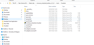

    > Can you please explain it more for me, because how I can do the parsing in that function or if possible share with the lines of scripts with details may be I'm able to understand.
    > And I'm sharing a screenshot where I didn't find the oob_parser.py.
    Thank you!

  • Hi Fahad,
    I was giving the path to the visualizer/GUI in Industrial Toolbox 4.11 as that is what you were using before. It appears you have now updated to Industrial Toolbox 4.12. In ITB 4.12 the visualizer source code is located at <TOOLBOX_INSTALL>\tools\Visualizer and the parsing is done in gui_parser.py.
