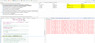

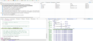

    But it will enter into Undefined instruction or Abort (prefetch) when step debug after mpu_enable with doing reset and load debug test without MPU_CSS_DEBUG  definition (no write access, just read and execute access), it works normal when I burned to flash and do flash boot.
    I continue to step assemble debug after the cpu enter undefined mode, get the PC = 0x3620A
    I reload mss out file to see the codes in address 0x3620A
    There is a different data in the same address between  I step assemble to enter abnormal and to see the ram data and  only reset , load out file with stay in main entry, I continue to debug step by step, it executed normal when it reached the 0x3620A address after the MPU_enable(). Just because the codes I watched the 0x3620A  memory when stay main entry? It work abnormal in the before abnormal address just because without watching the memory?  When does the codes to really load to TCMA memory in CCS debug.
    3、just run
    It will stay in funciton __TI_writemsg like below when I load and run without breakpoint debug.
    After  reconfigure the TCMA memory with no write permission when it reaches to MPU_enable(),  I suggest some codes it don't really exist in TCMA. It will load to memory when it need to run other codes, but at this moment, if the TCMA has no write permission for ccs debug to load codes to. It will fail just display in console window:
    Cortex_R4_0: Trouble Reading Memory Block at 0x40a62 on Page 0 of Length 0xa8: (Error -2043 @ 0x40A66) Unable to clear requested breakpoint from memory. Reset the device, and retry the operation. If error persists, confirm configuration, power-cycle the board, and/or try more reliable JTAG settings (e.g. lower TCLK). (Emulation package 8.1.0.00012)
