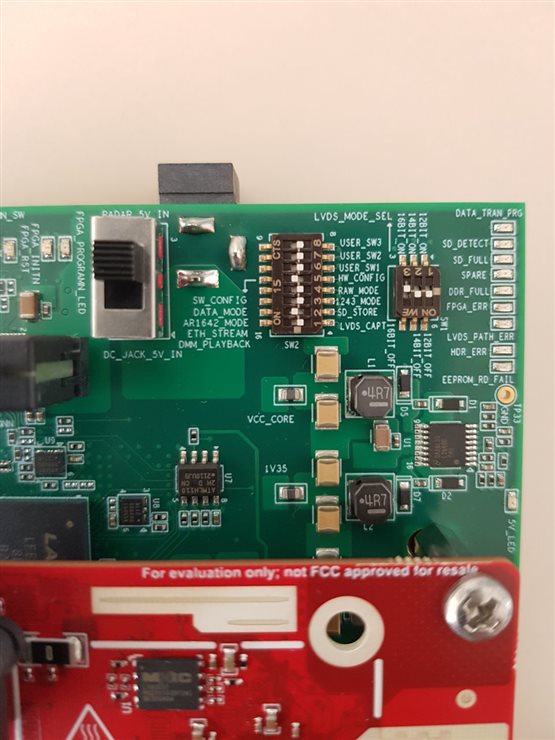

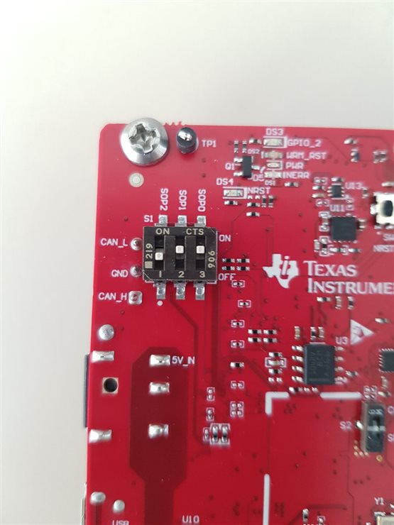

I am recently starting to get my hands on capturing raw data using the DCA1000EVM board with an IWR1843BOOST device. I have followed the video-tutorial and read the user-guide and documentation for the DCA1000EVM, but I am not being able to connect to the IWR1843BOOST through SPI. I am able to connect to the FTDI and RS232 ports, but not to the SPI. I have installed all the drivers, and my computer detects the same COM ports as in the user-guide.
Both devices are brand new. I have flashed the out-of-box demo in the IWR1843BOOST to test it. And I am using mmWave Studio with the MSS and BSS files provided in the installation files. But when I try to connect through SPI (step 5 in mmWave Studio RadarAPI) the applications hangs and closes.
Here is a picture of the hardware configuration:
IWR1843BOOST
  DCA1000EVM
I have read other posts and tried their solutions, but none worked. And some had a previous version of the board because the SOP modes had pins instead of switches. I also tried to connect the IWR1843BOOST without the DCA1000EVM to mmWave Studio with no luck. The only difference with respect to the user-guide is that I am powering the DCA1000EVM using the radar 5V in from the 60 pin radar connection instead of having a separate power supply. I do not have another one at the moment. I hope this is not a problem.
Is there anything I am missing?

  • Hello Felipe,
    I can help you with DCA1000 error debugging. First off I would like to point you to our DCA1000 User Guide located in our Industrial Toolbox for mmWaveSensors (https://dev.ti.com/tirex/explore/node?a=VLyFKFf__4.12.0&node=A__AGTrhNYW8jE6cMxbovlfaA__com.ti.mmwave_industrial_toolbox__VLyFKFf__4.12.0).
    Within the "Need More Help?" section is the DCA1000 Debugging Handbook. The most common errors involving the DCA1000 is covered in this debugging handbook. Can you send me the log that includes the exact error when you try to connect to SPI? The error code (returned X) can mean different things and can potentially help me with debug.
    I want to let you know from the pictures you have taken that USER_SW1 (Switch 6) must be in the ON position and in your picture it is off. Also make sure your IWR1843 is in "Development Mode". This is SOP0 and SOP2 being on with SOP1 being off.

  • Hello, if I configure the IWR1843BOOST with SOP0 and SOP2 on and SOP1 off (which is flash programming mode as stated in the user guide), I am unable to connect to the RS232 port with error "[RadarAPI]: Error: Connection failed: Calling_ConnectTarget returned 3". Only when in debug mode (011, SOP2 SOP1 SOP0) I can establish this connection correctly.
    With respect to the DCA1000, I have enabled the USER_SW1 switch as suggested, but the problem is still not solved. I have tried to see the error code, but the program freezes and then it is automatically closed. I have the log until that point:

  • Hello Felipe,
    So there are three SOP modes that the user generally will use with the mmWave sensor. First is flashing mode which is when you use Uniflash to flash a .bin file. The second is functional mode where you send CLI commands to start the sensor. And the third is the development mode which is what you need for the entirety of time with using a DCA1000. SOP configuration for each mode is different per device, and you are correct that 011 is development mode for the IWR1843, my mistake.

  • Hello Felipe,
    One more thing to look at. Near your SOP switches should be a MUX switch that is on or off. Can you confirm that it is set to SPI? If not set to SPI and try again.
    Pedrhom Nafisi
  • Hello Pedrhom,
    It was this switch. I set it to SPI and now SPI connection is properly established.
