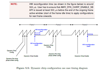

My customer is considering using the adv frame and dynamic reconfiguration. Below notes and time diagram confuse me a lot. Need your help clarify, look forward to your comments soon, appreciated.
  1. My understanding that dynamic chirp/PS config can be called at any time as the configuration is stored in SW RAM and not applied until DYN_CHIRP_ENABLE is called, how to understand “Note that the configuration should be received by the firmware 10 ms before the end of the current frame.” Does it mean that the update configuration need at least 10ms to take effect after DYN_CHIRP_ENABLE is issued?
  2. How to understand the “HW reconfiguration time is around 500 us”? why it is need to issue before end of the ongoing frame active window? Can it be issued during frame idle time?

    Will check this with the team internally and get back to you with an update in a couple of days.
    Pradipta.
    If you issue the DYN_CHIRP_ENABLE API during the frame, then the changes will come into effect from the next frame. If you issue the API during the idle time of the frame, then the changes will come into effect one frame after and not in the following frame. So, depending on how you want the changes to take place you can issue the API as per your application requirement. Also, you will need to meet the 10 ms timing constraint for phase shift API if you want the changes to take place in the very next frame.
    Pradipta.

    1) in the above quote, do you mean during the chirping?
    2)Pls help confirm, If I want the dynamic changes take place in the very next frame, the right way is :
    ①Call AWR_ADV_DYN_PERCHIRP_PHASESHIFTER_CONF_SET_SB while the current frame is still chirping.
    ②AWR_ADV_DYN_PERCHIRP_PHASESHIFTER_CONF_SET_SB should be issued 10 ms before end of current frame.
    ③if PROGRAM_MODE is 1, we need to issue AWR_DYN_CHIRP_ENABLE API 500 us before the end of current frame.
    ④the dynamic changes take place in the very next frame
    Please find my comments below.
    Comment) Yes
    Comment) Yes this will the correct way to have the changes take effect in next frame.
