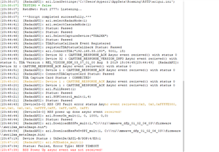

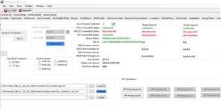

I have an issue with powering up device 1. I am following the cascade user guide. I have attached the screenshot of both mmwave studio and output.
Please kindly advise what I can do to power up the device.

Please update the studio to the latest MMWAVE studio 2G and latest DFP. Once you do that the device on your cascade board would be detected correctly instead of "undetde".
It did not resolve the issue yet.

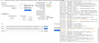

I have updated the mmWave studio to 3.0.0.14 and firmware. After SPI connect device 1, I upload the BSS FW file shown in the attached figure, but there is an error. Is this the right file?
Thank you.

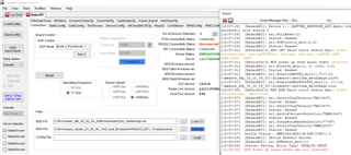

Also, I tried loading the meta image file, but still,
there is an error and it does not power it up. It would be helpful if the user guide specifically indicate which file name to be uploaded. I am attaching another image of the error. Please advise which is the correct file for BSS FW upload or if is there any other issue that you might be able to determine from the output file.
Thank you.
The studio and DFP version seem correct. Can you please share the log file of studio?
The metaimage file is the only file which needs to be loaded/flashed.
