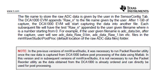

    To understand the data, I followed our regular data capture using the mmwave studio and DCA1000.
    Output is coming correct. Here I have a confusion on data . How the adc_data_Raw_0.bin and adc_data.bin differ in terms of actual ADC radar data ? It seems to be same in size. please let me know to understand the difference (any conversion /rearranging is doing here) . My UDP packets is same as adc_data_Raw_0.bin, but I need to convert  UDP packets data to adc_data.bin data format /arrangement.
    Please provide a link or a reference to understand more on this ?
    Resmi Johnson
  • HI, there:
    There is no difference between adc_data_Raw_0.bin  and adc_data.bin.  Please refer to the mmwave studio users guide section 3.3.
