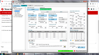

I have purchased PGA970EVM, in that ADC data is not reading.
Request somebody to help me in fonfiguring.
I, have looped back Primary output as Secondary input.
In GUI the read vale shows "0".
Settings are shown in the adove screen shot.
Saravanan
  • Hi Saravanan,
    Have you enabled both the LVDT loopback connection in LVDT_LPBK_CTRL, and also the loopback amplifier itself in the DAC_LPBK_CTRL register? It can be easy to miss the LB_AMP_EN bit if you only intend to use the LVDT loopback, since it is in a separate register. Please make sure LB_AMP_EN is also set to 1.
