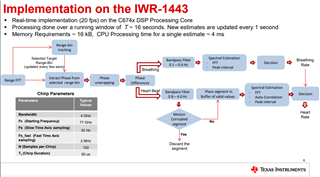

Hi TI
Can you please let us know where to check the operation frequency for Vital sign lab as mentioned below guide?
Customer would like to adjust the clock speed to observe symptoms when change the clock speed from 77 to other values.
Jack
