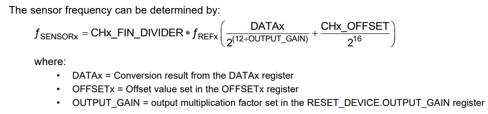

    Here is another interesting observation from the LDC. We are currently making use of the output gain feature, which allows us to read 16-bit value (ENOB). For the same purpose, we are also using the offset feature. However, I noticed that there was a considerable shift in the offset, although the change was not observed in this 16-bit value.
    Formula used ->
    FIN_DIVIDER - 1
    OUTPUT GAIN - 4 (16-bit value)
    Reference Frequency is considered as 20 MHz (clock divider of 2 was used on source of 40 MHz). The datasheet specifies a mid value of 43.4. However, for computation purpose, we assumed it to be 40 MHz.
    We are currently making use of the internal clock of LDC1314 as reference frequency. Could this be the source of such an offset?
    Highly appreciate your help! Thanks!

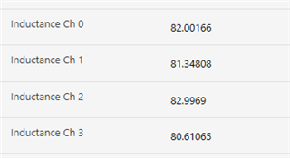

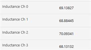

    I performed a test by changing the sensor frequency from 4 MHz to 2.4 MHz, by including bigger caps in the circuit.
    This was the inductance reading from OK batch ->
    This was from NOK batch ->
    Note -> inductance calculation was not changed in FW, and hence the large values.

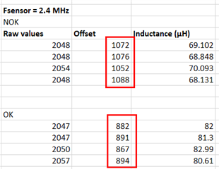

    The offset in measured values is still visible. Here is the raw measurement values and the offset configured for every channel, with corresponding inductance calculated.
    This clearly indicates an offset, which is not affected by the sensor frequency. It will be great if you can help me discover the source of this issue! Thanks!
    Naveen.
  • Naveen,
    In your most recent reply, how are the Raw values and Offset related?
    John
  • Hi John,

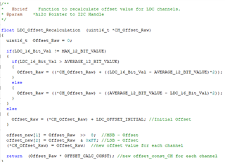

    The raw values are set in such a way that they are closer to 0x7FF. The offset is recalculated and the LDC is configured with this offset (unique for each channel), until we reach the measured value close to 0x7FF. Then, the actual value is calculated according to the formula specified in the datasheet .
    It was the same as the previous measurements I did, with fsensor as 4 MHz.

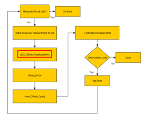

  • Hi John,
    It has to be noted that the procedure has not been changed and only the capacitance on the coil side was changed to bring the 4.0 MHz coil frequency to 2.4 MHz. The settings remain the same, since there was no major drawback noticed. Nevertheless, I am describing the steps below, by means of flowchart.
    As seen in the flowchart above, after the initial configuration of the parameters (apart from output gain) using Multi_Channel_Config function, the Output-Gain configuration is done (using RESET register, as specified in the datasheet). In order to have a much effective measurement range, the offset is set in a way that the measured value varies around 0x7FF. For this, a special function called LDC_Offset_Detection is used, whose flowchart is provided below.
    As seen in the flowchart above, all the coils are individually measured at first, and then using the LDC_offset_recalculation() function, the proper offset is determined (using the formula from the datasheet), to obtain a measurement value around 0x7FF. The actual FW code used is given below as a screenshot.
    Once it has been determined that the offset is good enough, to obtain a measurement value around 0x7FF, the new offset is configured individually for all the channels, and the normal measurement run is started.
    Naveen.
