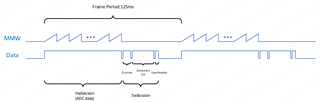

we use PC, AWR2944EVM and DCA1000 to collect the radar data as following diagram:
the MMW and data sequence as following diagram:
The size of each data segment is shown as following form.
Session
SubSession
Size(byte)
HwSession
ADC data
1,572,864
SwSession
Dummy
5,440
Detection list
56,784
Userheader
1,456
 Total
1,636,544
Tips: These data have aligned by 64bytes and 1456bytes

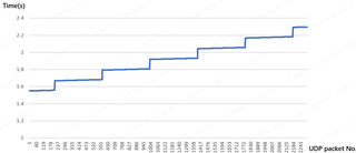

Problem
We collect the UDP packets from the DCA1000.
In theory, we should receive 1124 (1636544÷1456) UDP packets per 125ms, but only receive 390+ packets per 125ms actually (shown in the diagram).
So when we process these data, the result is not the expectation.
Our preliminary analysis is the AWR2944EVM occupy the DCA1000 too much time, so DCA1000 can't transmit the LVDS data timely.
Could you hlep us to find the root cause and solve this problem?
